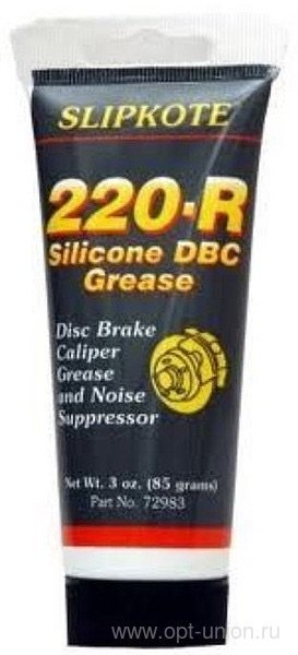

1. Slipkote 220-R или Slipkote 211

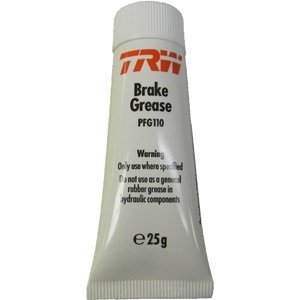

2. TRW PFG110
2. TRW PFG110
