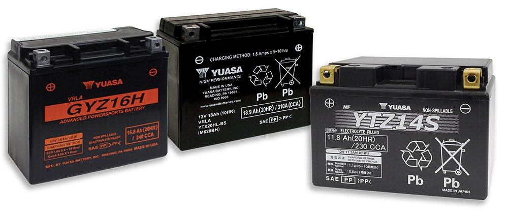

The Ranges
Yuasa have an extensive history in making motorcycle and scooter batteries. For over 40 years we have been trusted by manufacturers and millions of riders worldwide.
Although widely used as the standard references, YTX®, YTZ® and GYZ® are registered trademarks of GS Yuasa International Ltd. Only Yuasa and GS manufacture genuine YTX®, YTZ® and GYZ® motorcycle batteries.
Yuasa YTX
In Yuasa YTX® batteries, all electrolyte is absorbed in special plates and AGM separators. Advanced lead calcium technology pumps up the starting power and this maintenance free range will last up to three times longer than conventional batteries.
YTZ
Yuasa’s world famous high performance YTZ® battery range is a favourite amongst powersports enthusiasts. As the only motorcycle battery in the world to incorporate expanded plate technology, the YTZ® provides riders with maximum starting power from minimum space and weight. The unit’s completely spill proof AGM design also allows multi-angle fitment.
GYZ
Yuasa GYZ® batteries have a longer shelf life than any other battery in production and improved life cycle performance. The GYZ® series are a perfect upgrade for customized motorcycles requiring the best performance available in the market. They come factory activated and are therefore easy to handle.
