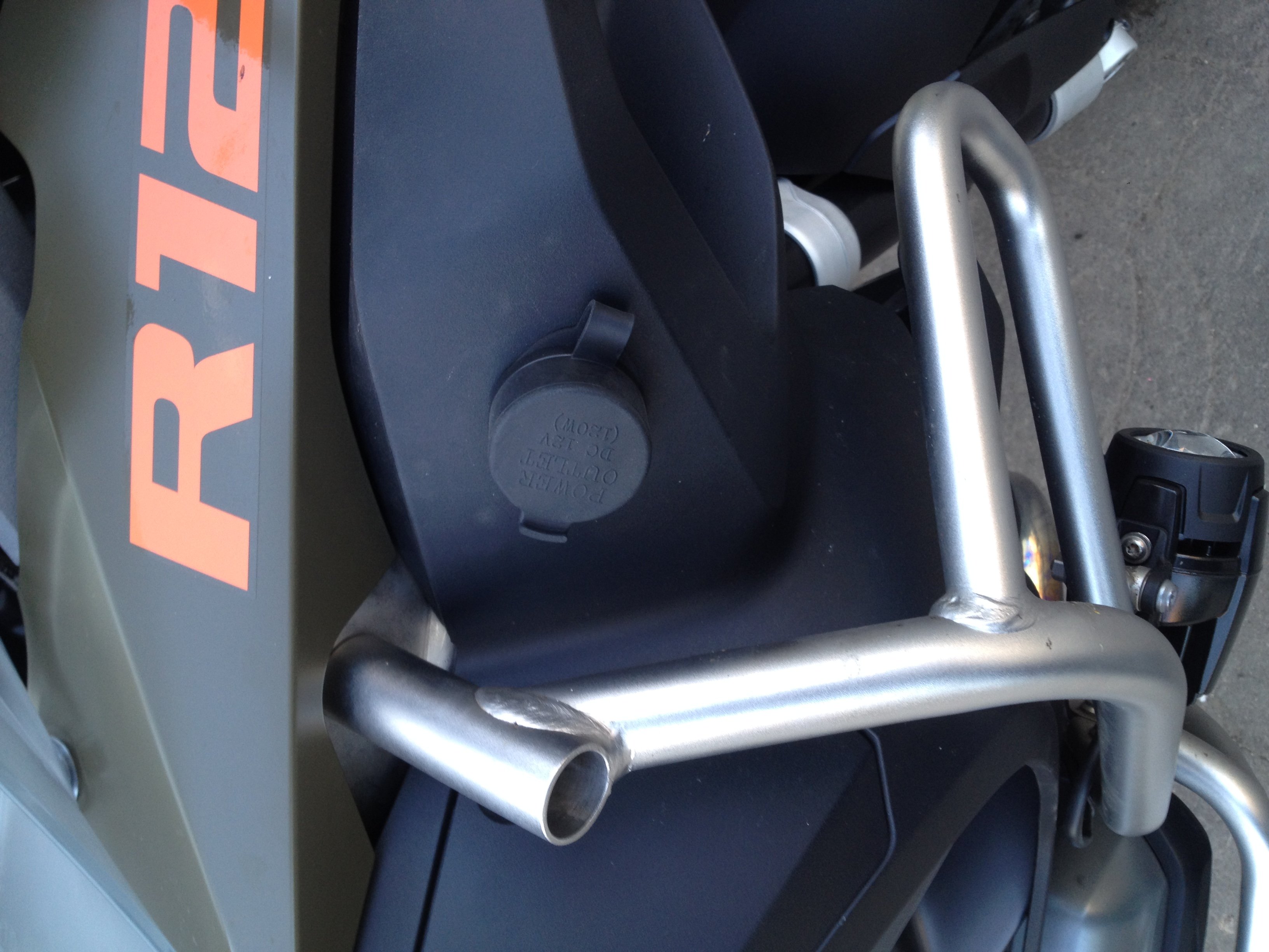

https://www.bmwcats.com/moto/K50/55470/0:0:-/77/77_0251/
